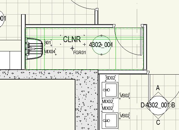

My interior elevation markers are causing me some grief.
It would seem the elevation pointers on the marker have been turned off or deleted somehow, yet the individual interior elevations still exists? I cannot, for the life of me, find a way to turn these back on. The only workaround is recreating the elevation marker which is way too time consuming....please help
1 REPLY 1
Can you ALT-click on a good one and then CTRL+ALT-click on the bad one to select and inject the correct properties.
You may have to rename the elevations.
