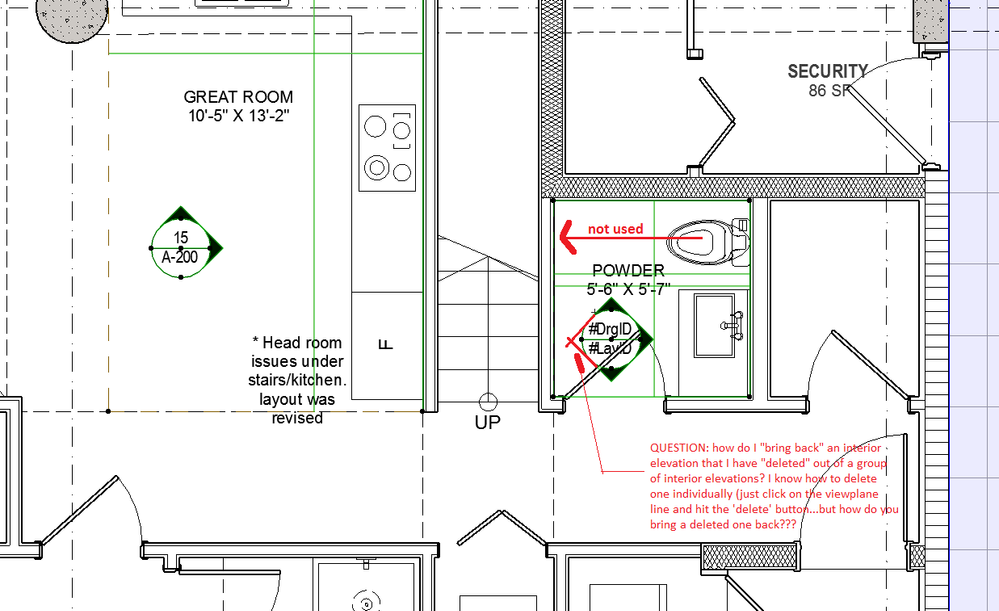

how do you 'bring back' a deleted interior elevation from a group of them which you created as a 'grouping'?
see diagram.

Select your elevation group and then left mouse click where the extent of the deleted elevation is.
In the pet palette there is an option to "Revert Segment" (top right icon).

here's what it looks like graphically.
thanks for the quick response/solution!...you guys are the bomb here!
