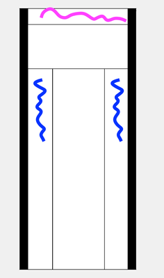

Hi! Really trying to not be emotional and stay super patient with archicad and myself (it's hard though). I can't figure out how to set up fills for walls/ceilings/cabinetry/slabs/soffits whatever that is crossing in elevations views. I am sure "I am missing something".
On top (pink) its soffit that should be grayed out... and on sides (blue) that is slabs that should also be grayed out or whatever I want it to be. I would be however happy with very little! if I just can't stop adding the fills manually.
This is just ONE room (pantry) but it does it everywhere, just white. I am so over it.

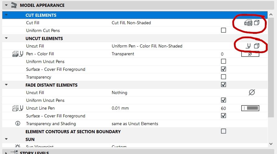

You may want to check you section setting and how the model should display (see attached screen shot).

Ok I found the settings for the election & unchecking "uniform uncut pens" definitely did something so that is a progress - but only as far as single color. But still, any of them do not show "fill" like cover (dot & dashed) which is what I want to see when walls or cabinets are blocking from profiles if you know what I mean. I know other softwares do it because we used archicad and revit. Does it work for you this way?
I am attaching what I want to accomplish (left side) & settings including the slab setting for example.
I noticed in the slab setting itself, I only see "cut fill background pen" but I don't see a fill there... Maybe that may be it? but why it would not be there fill and only color? I am confused :D.
