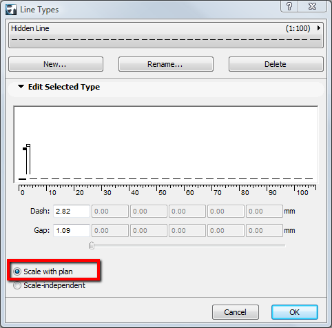

I think you need to change the line type scale to "Scale with Plan", This option means that if the scale of the drawing is changed, the lines will grow or shrink proportionally.
Hope this helps

How are you changing the scale? Are you creating a new view with the reduced scale or are you overriding the scale of a placed drawing through the drawing settings?
The later method would result in the problem you describe.
