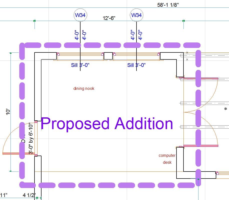

OK Here are some images that explain things.... this is the result - no bold lines - this is how it appears on the layout AND when I print the page on paper.
Another Image... this is the view showing real line weights 'on-screen'...
