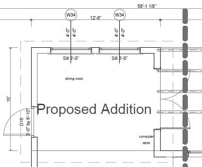

Is there a reason why lineweight is ignored? I adjusted my pen weight for pen #201 to 3mm - I need a bold line for graphics purposes - but when I place the drawing on a layout and publish as PDF, the lineweight is lost!
Does anyone know why?

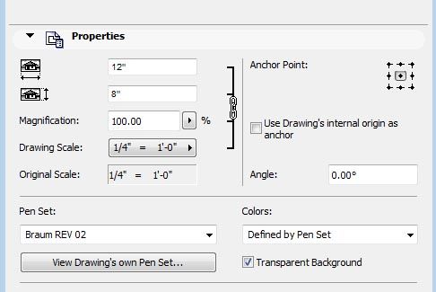

Another Image... this is the drawing properties from the layout book - indicating which pen set is used....
Here is the Pen Set list from the Attributes Manager....
One thing I may have overlooked..... notice that the line on screen is 'pink' and the pen #201 is 'red'. I should note that I drew the original line using the mark-up tool, and then changed the line after drawing it.
I will check to see if this is the source of the problem.
Here is a screenshot of the Mark-up tool dialog box... I should note that I haven't used this tool before...
Problem solved.... the mark-up tool was the issue... as you can see, I drew a new line without the markup tool, and the result is the proper lineweight. The image is from the resulting PDF.
So does anyone know why the Mark-up tool does not translate lineweights? Or rather, is it possible to edit the mark-up so that the proper lineweight is used?
Thanks...
I tested the theory by drawing a new rectangle using a heavy line, and using the markup tool to 'convert' the line to a 'correction'. The result is that the line i drew loses it pen weight and color.
So I guess this is now a discussion about setting the mark-up tools pen weight assignments? Is this possible?

No, you saw 'correct' behavior. Elements drawn with the markup tool will display with the markup style's pens until they are converted to normal elements. This is a 'feature'. 😉
I've been frustrated with the 3D appearance of markup elements - similar kind of thing as you've run into.
Might be worth posting a wish that we have a Model View Option that permits Markup Elements to be displayed with with markup attributes or with their own attributes. Would make using markup for design alternatives much more useful.
