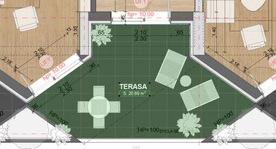

Hello. I am trying to create a zone list in which to display the net surface of the walls surrounding an area. (toatal perimeter X Height - total surface of doors, windows). For example: in the balcony area calculate only the facade wall ( not to count the railing as a wall). Below i attached a photo of my example. Thank you.

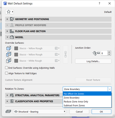

Select the railing walls and in "Model" rollout change the relation with zone to "No effect on Zones". Hope this will help you.

Hello Rajesh,
Thank you for your suggestion. It helped. 🙂
