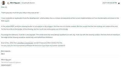

looks very similar to my query a couple of years ago:
https://community.graphisoft.com/t5/Documentation/Protruding-Dots-at-Drawing-Boundaries/td-p/313299
TL;DR, it's a PDF exporting issue & they won't be doing anything to it (unless they have in the last 2yrs in the newer versions???):
