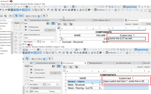

Cannot fill the Schedule's Custom text field
Gisele
I am unable to type number or letters in the Schedule's Custom text field.
AC 26 - 5002 USA FULL
Win11 Pro 22H2 - 13th Gen Intel(R) Core(TM) i9-13900KF 3.00 GHz - 64 GB - 64-bit operating system, x64-based processor
4 REPLIES 4
Steve Jepson
Seems to work ok in 25 and 27.  I don't have 26 to check.  Sorry.

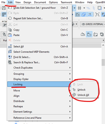

Gerry Leonor
then check if the element is Element Locked. if it is, unlock it.
if that doesn't work, check if the layer that the element belongs to is also locked or not.
