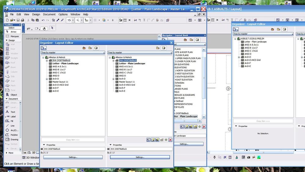

laszlonagy wrote:OK, here is a screen shot, I'm trying to copy the master layout highlighted on the left, into the project on the right. I was unable to drag-and-drop it like I think I did it last time. Is there another way to import a master layout?
I have AC13 on Vista and have no problem doing it.
Can you show us a screen shot of how you are trying to do it?

Laura wrote:I'm missing something, I don't see how to open the file I want in the left panel...
Use a SINGLE Organizer -- In the file you want to copy to, open the Organizer, open the files you want to copy from in the left panel, and drag the Master(s) to the Layout Book in the right panel.

Laura wrote:I think the problem might be that the feature doesn't come with Starter Edition 2010....
Have you tried the Help MenuSee screen shot below.
