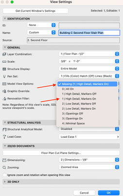

I am suddenly having the same problem. The saved view with the correct MVO (no minimal spaces) is showing minimal spaces when I place it on the layout but not in the view.  It seems to have come out of nowhere!

this is interesting... somehow the MVO I had set up has gone missing, despite the fact that they are still available and have not been modified.  This feels like a bug.   

You tried to update your layout, check if Auto or Manual.

@Mahmoud Qenawi Its always been set to Auto update... there is a bug with the MVO in the view settings where it keeps losing track of the MVO if I make an adjustment to the MVO then keep it as the same name.

I understand you, only I try to be sure if it's a bug or a trick may help you.
Have you changed the MVO in progect map and going to the view map and click redefine with current view settings?

Well if it is indeed a trick it is a stupid one that does not align with the functionality of the rest of the program.
ArchiCAD:  "oh you redefined a setting in a view set?  now I'm going to make you chase it around on all of the drawings that contain that setting!  HAHAHAHAH HAVE FUN!"
That's annoying.  Not clever.
