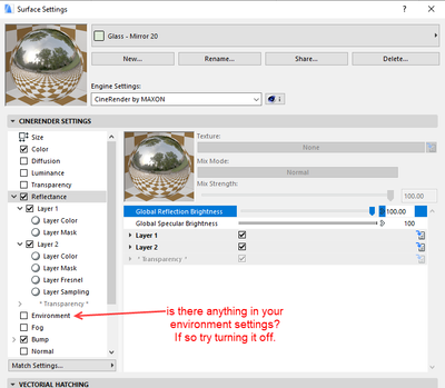

So is there anything in the Environment settings for your material?
This is an image of the glass mirror material from version 20.
That is all I have loaded at the moment.
I just tried it and it reflects the surroundings just fine.
I can't remember if this is from the standard material catalogue that came with Archicad or if it is one of the extra materials from the extended catalogue that comes with the subscription agreement .
I just did a 'New' material and chose from catalogue to get it.

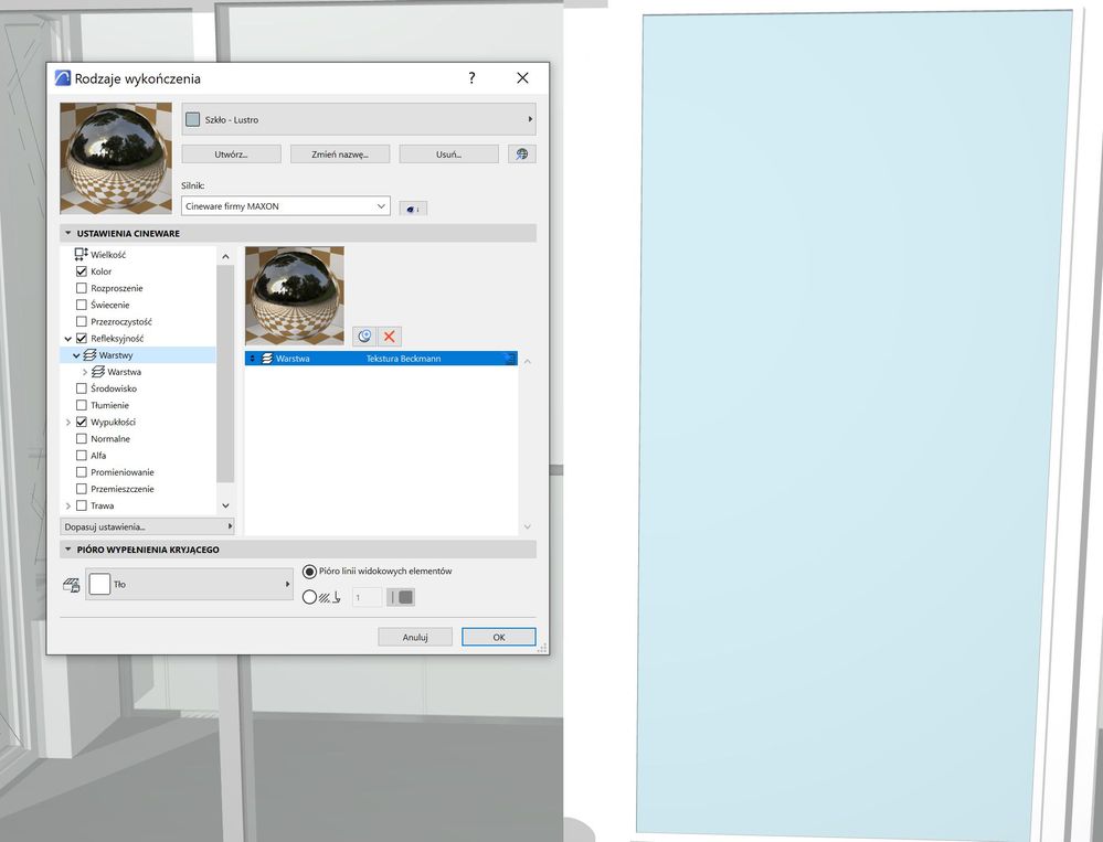

Screenshots are in Polish (sorry) - however, the environment settings are turnned off, Ive only got Colour, Reflectance and Bump selected. As you can see - on rendering I can see the sky. Ive also done rendering after adding a ceiling - trying to seperate the outter environment - hoping that would make a difference but didnt work..
I'll give the second option that you mentioned a go..

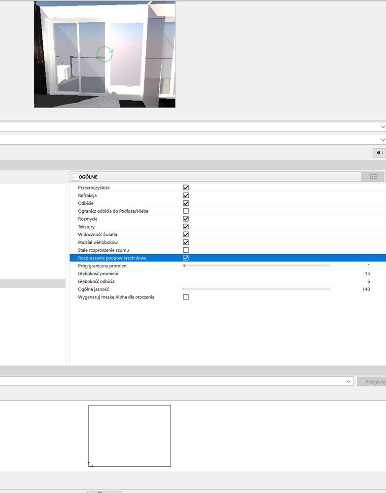

Ive mirrored the setting you have selected and still does not work..
Your 'Ray Threshold' is only 1.
Try increasing that a bit.
