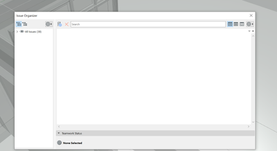

Hi Good day, how to resolve this bug in issue organizer in ArchiCAD 26. When you use the display view so long then back to list view then it will be missing. Thanks

nothing even I click there

We have the same issue in our office. ArchiCAD 26 build 7005.
The list is blank, there's nothing we can do about it other than use thumbnail view (not handy). Also when you click on plan to show containing issue it just opens the organiser and doesn't point to anything. Same with assigning an issue to somebody, they will receive a message and no link to the issue. Just the issue organiser opens.

Having the same issue here in ArchiCAD 29.
Issues show up fine in grid view but list view shows nothing.
I was about to teach my coworkers how to use issues, help 😅😭

I've opened a new file and it happened again, right from the start.
After reinstalling ArchiCAD29, it seems to work fine, for now.

Yep, went back to it.
After interacting with the issues in grid view for a while, list view is useless again.

Got no updates, but this is still happening.
Who should I talk to?

Can you try something?
Can you save a PLN Archicad file? Then, open this PLN file. Are the Issues missing in that file as well? This way, we will see if this issue is Teamwork-specific or more general.
