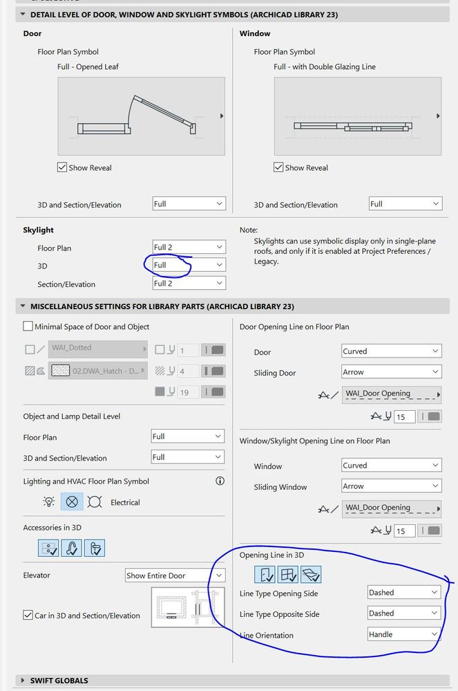

MVO settings can be modified at the following:
Document => Model View => Model View Options... => [Relevant MVO] => Detail Level of Door, Window and Skylight Symbols => 3D and Section / Elevation => Full
This dialogue can also be accessed from the bottom of your model window by clicking on the two squares inside of each other. Clicking on the text next to this icon will allow you to select which MVO preset you wish to use.
Unless you have special instances, you should leave the 3D Detail Level setting within your objects to "by MVO"
