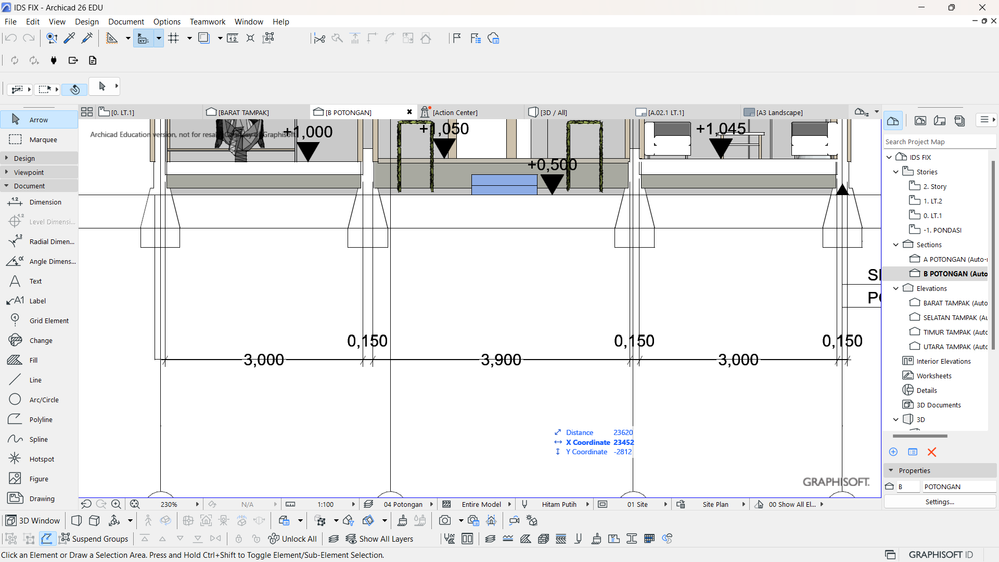

Hi. I've put notations in my drawings yesterday, but when i re-open the file, it's gone. I haven't touched anything, it just disappeared. Not only the notations I put by using fill, but also the notations that comes with the element. I tried to re-build it, but it doesn't help. Please, if anyone knows how to solve it, let me know. Thank you

Hi @Talitha Tarra.,
Your Model View Options & Graphic Override Combinations are set to Site which affects fills to be transparent, Is this intended?
