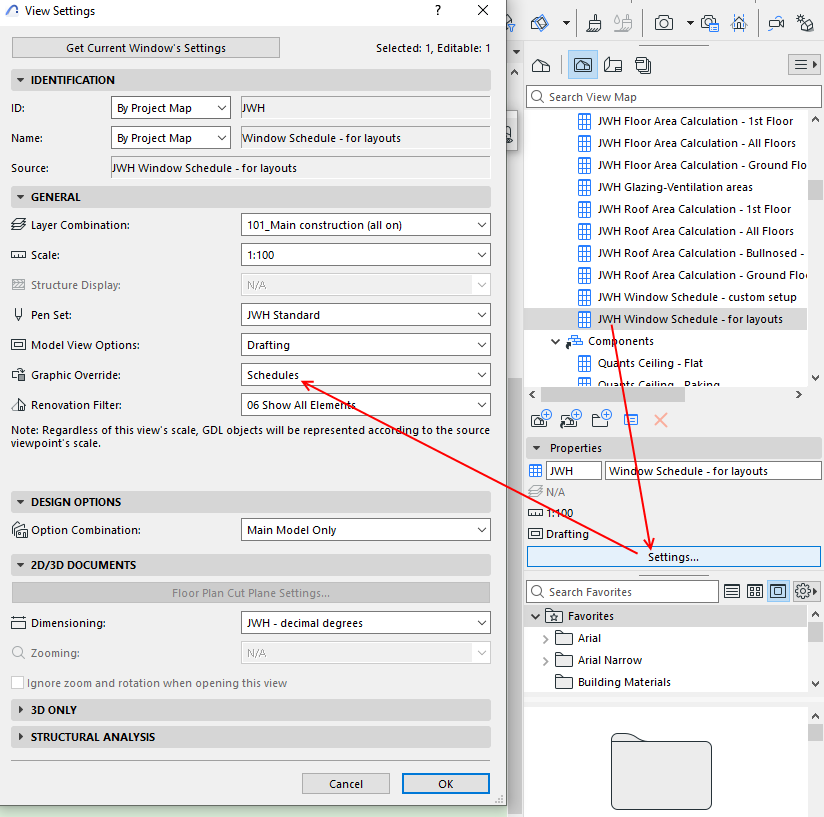

You need a graphic override that makes fill backgrounds transparent.
This is the rule you need - I am pretty sure it is in the default template.
Add this rule to a Graphic Override Combination and then use that GO combination when viewing the schedule.
Save a view of the schedule and you can set that GO combination there so it is always automatic.
I have a GO combination called 'Schedules'.

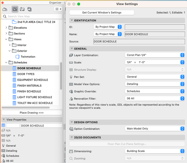

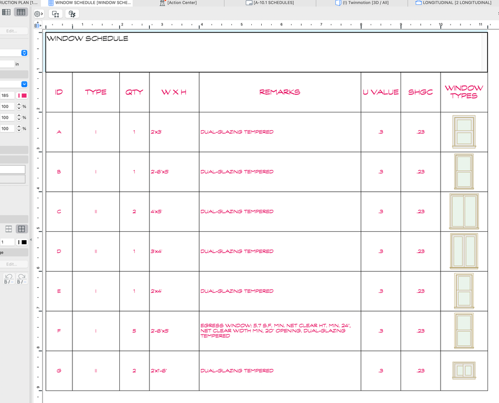

I'm trying to set it up as you explain, but for some reason it's not working. I set up a GO called Schedules. I applied the GO in the settings to the door schedule. Changing these settings not affecting the window schedule either, it seems. I attached a window schedule as well. Should I try creating new schedules?

It seems you have created the rule and the GO combination, but you have not added the transparent background rule to the 'schedule' combinaation.
svpribyl
Barry, that worked! You are brilliant! Thank you!
