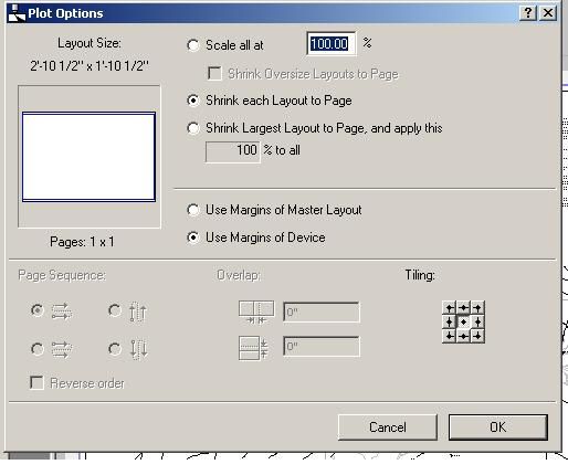

I have a dwg from a surveyorof a siteplan with there border included (this is usually the case). It was drawn at 1/8" = 1'-0" and was opened into AC7 without a glitch at 96 scale factor ( and AC scale previously set at 1/8" = 1'-0") All text was changed to Arial Narrow. I created a PMK in AC7 in which to import into PM3. when plotting this layout (Arch D size) the output is not to scale. When checking my "plot options" the radial button was set to "Shrink each Layout to Page". If I try plotting again with the option set to "Scale at 100.00%" the preview screen shows that 2 pages will be printed. If "Shink Oversize Layouts to Page" is selected then output is back to 1 page. Clearly if the border is stating 1/8" = 1'-0" then I do not want the output "shrunk". The PMK is well within the blue bplot borders.

I am actually "plotting" not "printing". Do you mean plottting? I did as specified in the "Plot Options" see attachment. The output is still 1/4" from the bottom & 1 3/4" from the top.

It can be seen from the attached scrren shot that the PMK is placed in the middle of the sheet. But it plots pushed to the bottom.

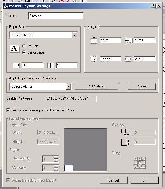

In my latest attempt at plotting to the middle of the sheet and at 100.00%, the proposed output of my 1 sheet jumped to 4 sheets After many trials it seems that the "Usable Print Area" in the Master Layout settings changed to 2'-11 13/16" x 1'-10 1/2". I dont' know how? The current plotters Availible Drawing Area in the Plot Setup Dialog box stated X: 2'-10 21/32" and Y: 1'-11 19/32". It was as simple as clicking the "Apply" Current plotters Paper size and Margins to get back to 1 sheet of output at 100.00%.
It seems that the last (I don't know exactly hoaw may jobs) few jobs have been "shrunk" to 98.5% or something in order to plot on one sheet. So my drawings are actually not to scale
So now I am printing to scale, but even with the "Tiling" set to center the output is still skewed to the bottom of the page. The Work-around is to place small "Ticks" on the Master layout sheet in the lower edge of the screen output. This "pushes" the rest of the output up on the sheet.
I tried the Work-around with-out using "Ticks" placed on the Master Layout Sheet, by increasing the Bottom margin from 3/16" (default for my current HP DesignJet 600) to 31/32". See attachment.
The resulting screen view shows output with large border on the bottom (See attachment), yet the printout is again only 3/16" from the bottom.

I get the exact same results with the increase of the Top Margin to 31/32" and leave the bottom at the default 3/16".
Very puzzling, seems that at least for me the Margin settings are irrelevant....
