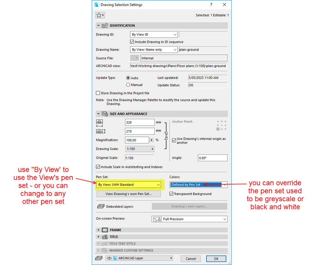

It could be controlled in 2 different places.
You should be creating a 'View' of your elevation in the View Map.
That View has settings which tells it which pen set to use.
That is the first place you can control the colours.
You should then be placing that View on the layout as a Drawing (with the Drawing tool).
That Drawing also has settings where you can control the pen set used.
