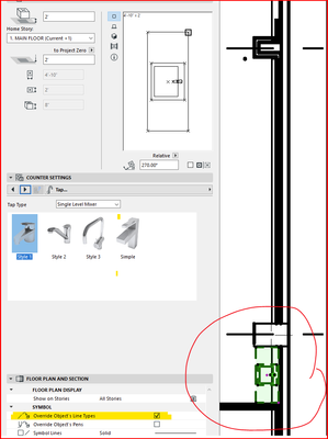

Placed objects show with dashed line type
This may be my understanding but.
Placing a Stock object
It is DASHED and not solid line as shown in this clip.

Steve Masey
Hi Eric,
Uncheck the "Override Object's Line Types" checkbox as highlighted below.
Hope that helps.

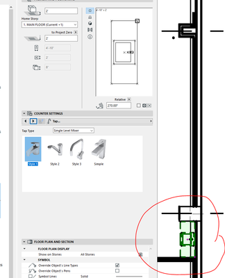

Eric Milberger
Thanks - is there a reason the default is to override reality?
Eric Milberger, Architect | Master Planner
Steve Masey
It comes in handy sometimes.  (I've used it a few times in the last 16 years).
Open the Object toolbox & un-check the "Override Object's Line Types" checkbox, otherwise the override will apply to every object you place until it's turned off.

Eric Milberger
OK I know about the objet toolbox for a singular item but do not know where to find a "Objects Toodbox"  that sets the standards.

Karl Ottenstein
Moderator Emeritus
It shouldn't be the default (e.g., opening a fresh project from the delivered template).  But, every tool, not just the Object tool, uses its last settings for the next use.  It's up to you to check the settings if you have (ever) changed them.   This is another case where Favorites can be useful, as each tool can have a Favorite which resets it to (your) desired defaults.
