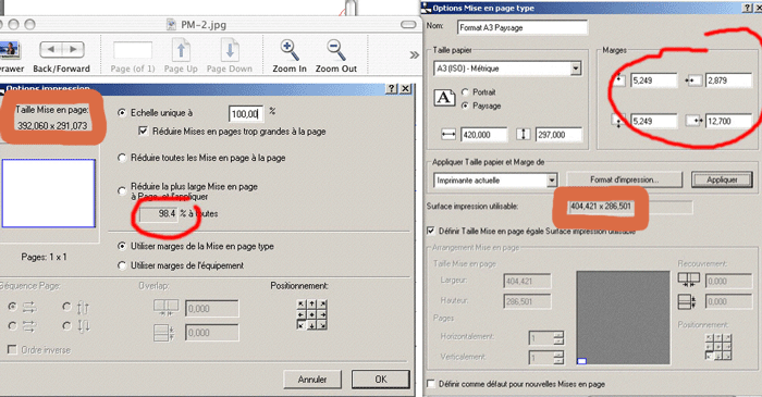

I've spent my last day trying to understand what is wrong with my Plotmaker :
I have noticed lately that all the drawings printed with Plotmaker had a problem with the dimensions (4 meters on the drawing were 3.9 meters on the paper....).Printed with Archicad everything was great.
I've been through the settings and found something odd (see the picture) that I later corrected which gave better results (4 meters on the drawing is 3.97 metres on the paper....)but still not acceptable for a professional software.I really don't know what to do.
Any help would be apprciated.

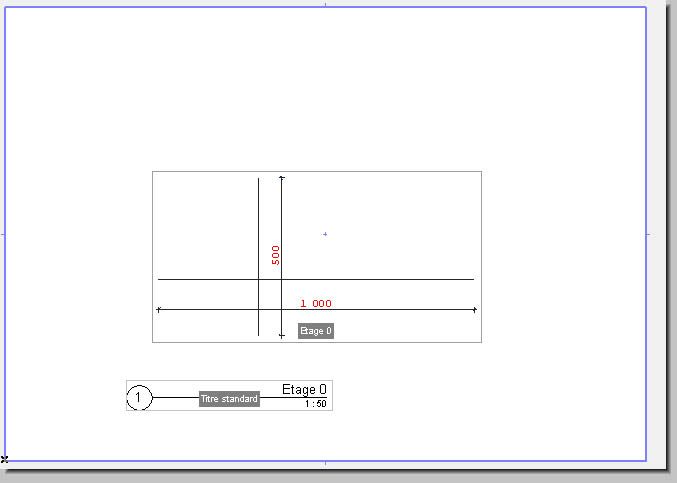

Started from scratch on Archicad with a "New and reset", drew a few lines with dimensions, saved my view, closed Archicad, opened up Plotmaker with a "New and reset", imported my view, printed.....the lines are too short the longest the line, the biggest the difference between the dimension and the reality......
I have tried all possible settings with the printer, even opened up the file on another machine, nothing works right.....the only thing that works perfectly is to print with Archicad.

The problem is that the size of the imported drawing is larger than the printable surface defined in your Plotmaker Master layout sheet so that in order to print the entire sheet Plotmaker reduces the drawing size to 98.4%.
Two possible solutions:
1. Utiliser les marges de l'équipment
2. Change the "taille de mise en page", make it bigger

Thank you for your help but it still doesn't work...as you will see on the attached file, the inserted view is way smaller than my sheet and my autotext elements are anchored inside of it.

Look at:
options d'impression 392,060 x 291.073
and
the options mise en page type 404.412 x 286.501
286.501 / 291.073 = 98.4%
