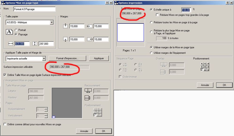

I've spent my last day trying to understand what is wrong with my Plotmaker :
I have noticed lately that all the drawings printed with Plotmaker had a problem with the dimensions (4 meters on the drawing were 3.9 meters on the paper....).Printed with Archicad everything was great.
I've been through the settings and found something odd (see the picture) that I later corrected which gave better results (4 meters on the drawing is 3.97 metres on the paper....)but still not acceptable for a professional software.I really don't know what to do.
Any help would be apprciated.

I have modified the settings (see the pic) but my lines are still too short and always that warning message........if at least PM could tell me what is wrong.....

When in Master layout setup go to print setup or plot setup (whichever method you use) and set your page size. Click on the apply button. Exit master layout setup and print or plot.

I think I got your file to work. Basically... go to the Master Layout setup, click on print setup and set to A3 paysage, validate and click on apply... then in the Print dialogue make sure that you have selected the A3 paysage and voila.
One thing... I use "publish to print" [rather than printing directly] and then print the resulting pdf file. Try it, you'll like it.

See the attachment. I don't have an A3 printer but using the Format A4 Paysage, on my A4 printer, everything looks OK
