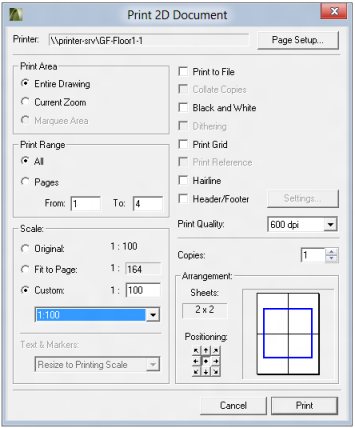

When Printing is the preferred choice
  • Printing Zoomed Area of a Model View: When you wish to output only the Current Zoomed area or a Marquee Area of a window, use the Print function. The Plot function will always output the entire view.
  • Printing Zoomed Area of a Layout: Although both the Print and Plot functions can output selected Layouts in the Navigator or the Active Layout only, the Current Zoom and Marquee Area options are only available for Layouts when using the Print function.
  • Scale Selection when Outputting Model Views: Use the Print function if using your original scale at the selected paper size would result in multi-page output. The Original Scale option is not available for plotted views whose content would not fit onto the current paper selected for Plotting. (In such a case, the Scale options in the Plot dialog box are limited to Fit to Page option or Custom scale, and the Custom scale must be such that the View content fits onto a single plotted sheet).
  • Scale Selection when Outputting Layouts: When printing or plotting Layouts, scale is set as a percentage (100% being Original size). Use the Print function if you want to set a custom scale that creates multi-sheet outputs. If you use the Plot function, you must set a custom scale that will create a Layout on a single sheet.Print Range: With Print Range, you can decide which pages of the output to print (selected pages or all pages). With Plotting, this option is not available. Arrangement: Use the Print function if you would like to position your drawing output on the page (e.g. lower left, upper right). When Plotting, the output will always be centered on the page.
  • Collating Copies: Use the Print function if you output multiple copies of multiple pages/sheets and you wish to collate them. (Please note that the printer must also support this feature for it to work and be enabled in the Print Dialog.) The Collate option is not available when Plotting. Dithering: Use the Print function if you wish to use the Dithering feature. However, the printer driver must support Dithering for it to be enabled and available in the Print Dialog.
  • Print Reference: If you wish to output the Trace Reference together with the model view or Layout, use the Print function. This feature is not available with Plotting.
  • Header/Footer: Use the Print function if you wish to define Header/Footer information for your output; this option is not available with Plotting.
  • Print Quality: Use the Print function to be able to choose the Print Quality from ARCHICAD (as expressed in DPI, or in Low/Medium/High etc. values). However, note that many plotters also allow you to set the Plot Quality on the Plotter.
