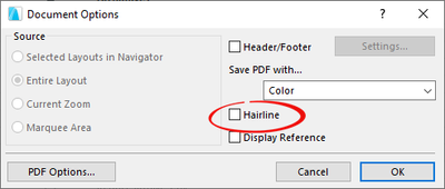

If you are 'publishing' to PDF then check the document options.
If you are 'printing' to PDF then check the printer options and there will be a similar hairline option.
