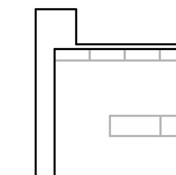

Hello! I have a weird issue where I try to print directly from the project map using CTRL+P and the resulting PDF's ignore the currently used pen set lineweight's. I have tried printing from the view map too (again I use marque tool to select the area I want to print from and CTRL+P) and similarly the lineweight's are ignored. When I use publisher set everything works perfectly only problem is publisher set is nowhere near as fast and efficient for printing when I need the drawings fast for any revisions and team discussions. Anyone came across a similar problem?

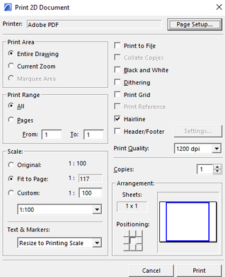

Is hairline enabled? If so it will print all lines at minimum thickness.

I also thought it could be the hairline but it is disabled. What makes it even more strange is that the outcome produces thicker lines than with 'hairline' selected. Below is printing straight from the project map and next is the publisher settings.

And you are sure that you have the same settings (graphical overrides and pen set) for the item you are printing and publishing?
wachaczaj
I double checked everything and they are the same settings.

I haven’t checked but when you print from the Project Map without ‘True Lineweight’ turned on it may print in a uniform thinner pen. Try turning ‘True Lineweight’ on in on-screen view options and print again.
