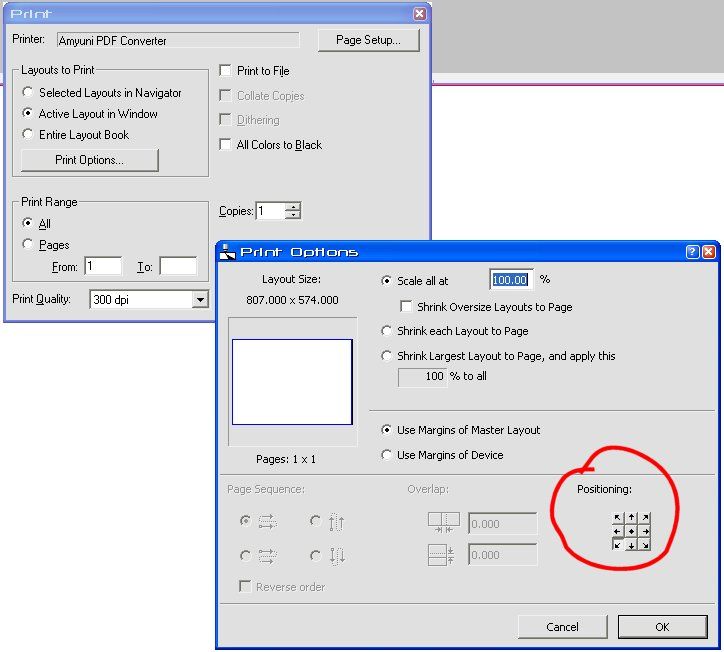

I have spent hours trying to set my margins the way i want them in Plotmaker 9 but failed. I have successfully bought in the correct margins for my printer but i want to mirror the margins so it prints with the bigger space on the left. I have tried swapping the left and right margins and it looks like i want it to on screen but as soon as i print it converts back to the original margins. HELP

What is your print options positioning set at?

A3 printer?
No can do. You can only define the same margin on the left as on the right - the right one being defined by the printer's hardware/driver
If we could rotate the print by 180 degrees, then it would be OK ... see the Wishlist for this.
