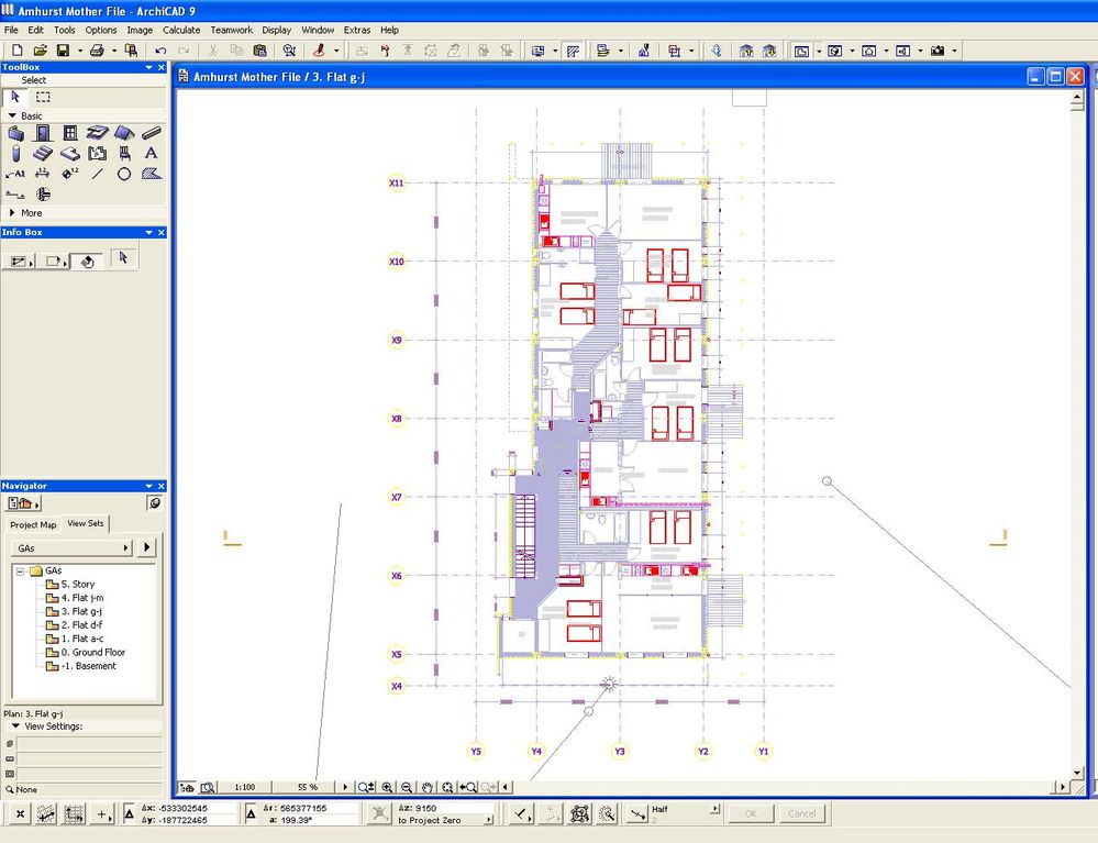

I am attempting to publish DWF from AC and tried a zillion different ways but it does not work.

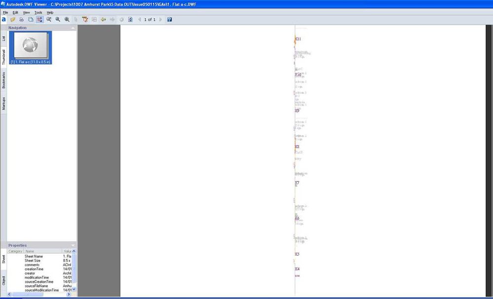

The first image shows the plan how it shoudl look at the second image shows what the published DWF file looks like.
Everything is squashed into one long line. Could somebody please help.
Thanks.

I have started a new reset file and merged the project and i get the same problem. everything is shown in one long line....
Another thing:
This project originated in AC8.1
I have opened 5 previous independent versions of this drawing (superseded) and they are all the same. When publishing to dwf it just drops everything into one central line on the page.
Any other drawing i open i do not get this problem.
It must be a problem with the *.pln file or the preferences relating to it.
