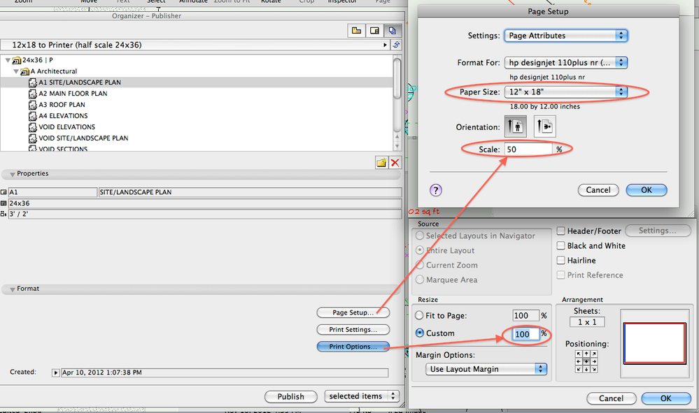

Stress Co_
Another way to do it, is to create a custom setup in Publisher.
I use this to print directly to the printer without first creating the PDFs.
You'll still need to create a custom paper size.
In Publisher, Format> "page setup"> select your paper size and set the scale to 50%.
In "Print Options", resize should be 100% (fit to page or custom) and use the "Layout margins".
When I do it this way, I turn on a text block that reads (in red)
Drawings Reduced 50%, Scale: 1/8" = 1'-0"
Make sense?
Note:
Something is messed up with my paper margins (thus the 3 red lines in the arrangement preview window)
