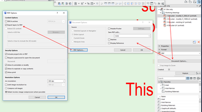

We are coming up against a pdf issue, our published plans are crashing Adobe Indesign.
Is there a publisher setting to remove the layers or complexity of the pdf when publishing.
(my work around is to open in adobe and save as other - remove detail) - it would be great to be able to skip this step.
Thank you!

You do have some options when you publish as a PDF.
For example you can turn layers off.
You will have to refer to the Help reference for what some of the other settings do.
