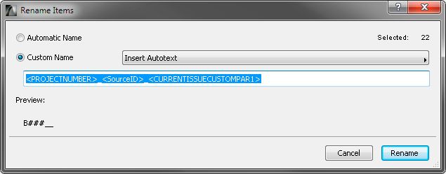

Searched everywhere...
Is it possible to have an automatic text in the Layout ID?
Our office template includes file naming with the Revision ID of each layout among other stuff. We have to change each file name by hand, renaming the files exported by the Publisher.
Would be great to have an export option which names each layout based on automatic texts.
thanks

If you are talking about publishing PDF, yes, it is very easy to rename a whole publishing set following a naming convention using autotext.

That's it! Thank you!
