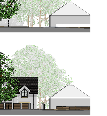

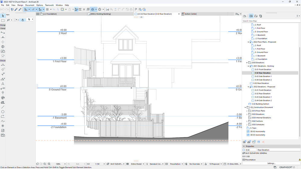

Hello everyone!
I am having issues visualizing the rails in elevations. As shown on the attached, I can see them in the proposed Renovation filter but i cant when it is on Existing filter.
I have tried messing with the renovation tool, Display order, Graphic overlay, layers but i cannot figure out how to resolve this.
All the railings are appearing white with no lines, therefore, i cant really see them on the elevations.
I hope this issue have a solution and not a bug.
Rikshay

NowArchRob
Did you find an answer Rikshay? I also have railings which appear differently in existing/proposed. No overrides, have checked renovation settings, can only assume a glitch?
I'm on Archicad 24 Solo UKI 7001
Part screenshot below:

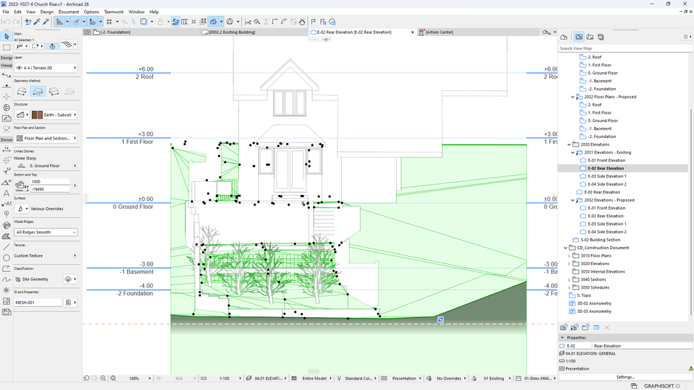

Railings have an overall renovation filter status, but each component of the railing can have its own as well, and it may be different.
Go into EDIT mode and see if the components have the same renovation status.

Histrianus
 It must be some strange kind of bug, looking at the IFC labels of the single components the handrail was set to "new", and the balusters were greyed out and were set "to be demolished".  I selected the railing, changed the Renovation status to "existing" and then changed it back to "new" and the lines appeared.

TRN
A forced renovation change solved the problem:
Renovation filter set to New (in my case)
  1. Change "ghosted" rails to existing (they disappear obviously)
  2. Change renovation filter to Existing
  3. Change rails to New
  4. Change renovation filter back to New
Now they appear in the New renovation filtered view.
