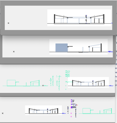

AC 25 USA 6000. These are two sections, parallel section markers with the same section settings, views with the same view settings, “ignore zoom and rotation” unchecked in all. Project origin is ~20 m to the left, as can be seen in the top two images.
When trace-referencing one section from the other one, the reference appeared on the left (3rd pic), when it should appear on top. Reset to Default Position made it appear *on the right* (4th pic).
After getting this repeatedly, rebuilding reference, switching reference with active, etc., I resaved the views from the screen. Now the reference always appears on the right.
This happens referencing both view and viewpoint.
I opened & repaired, no change.

I have seen this intermittently for many years and I haven't been able to resolve why it happens. It is one of those bugs that is easier to solve manually than try & report. The only thing I can think may be happening, is something isn't updating when the section is edited and the stored trace origin becomes displaced from the project origin.
