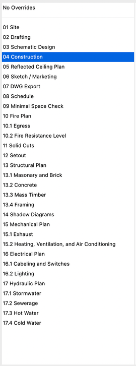

BYAArchitects
This is the number of Graphic Override Combinations we have in our Template File (please see attached image below). The number to the side aligning with the appropriate Model View Options we also have pre-saved...
As I've said before, we have a decent number of pre-defined, Model View Combinations Graphic Overrides Combinations, and it is not practical and user friendly for the way our office operates to have each of these as duplicates for existing and new and or demolition. If there is a specific rule that would work across all bases, being everything shows up correctly when on an existing, demolition and new, view. Then we're back in business... Otherwise, the option your proposing doesn't work, we have tried it.
Model View Options have nothing to do with renovations.
All you need to do is create a new graphic override rule for 'Existing - Grey' and add that rule to a new '18 Existing - grey' graphic override combination.
If you need plans that use the other graphic override combinations to also show grey existing, then add that rule to those GO combinations (schemes) as well.
The renovation filter you use (as well as the GO and MVO) is stored in the 'View Settings' of a particular view.
So you would create a view for your 'Existing Plan' and then set the MVO, existing renovation filter and the grey existing graphic override (or other override) that you want to use for that view.
