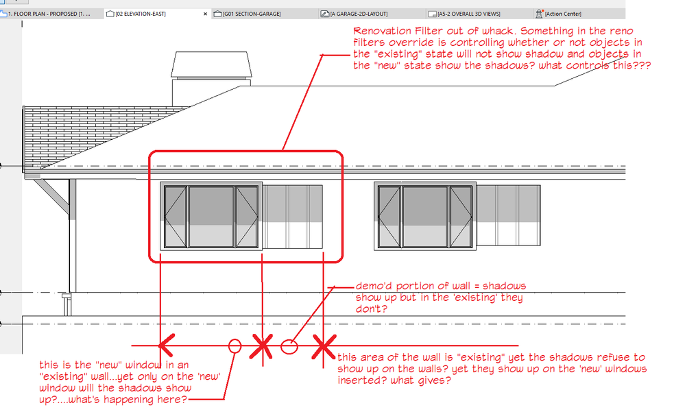

So..in a nutshell, shadows aren't showing up in walls that are left in an "existing" state, yet once a new window, door, opening, removed window in a demo state is created....then the shadows on the walls in their existing states....show shadows...........what's happening here?

I'm sure it's a renovation filter option setting that I just don't have it set right.

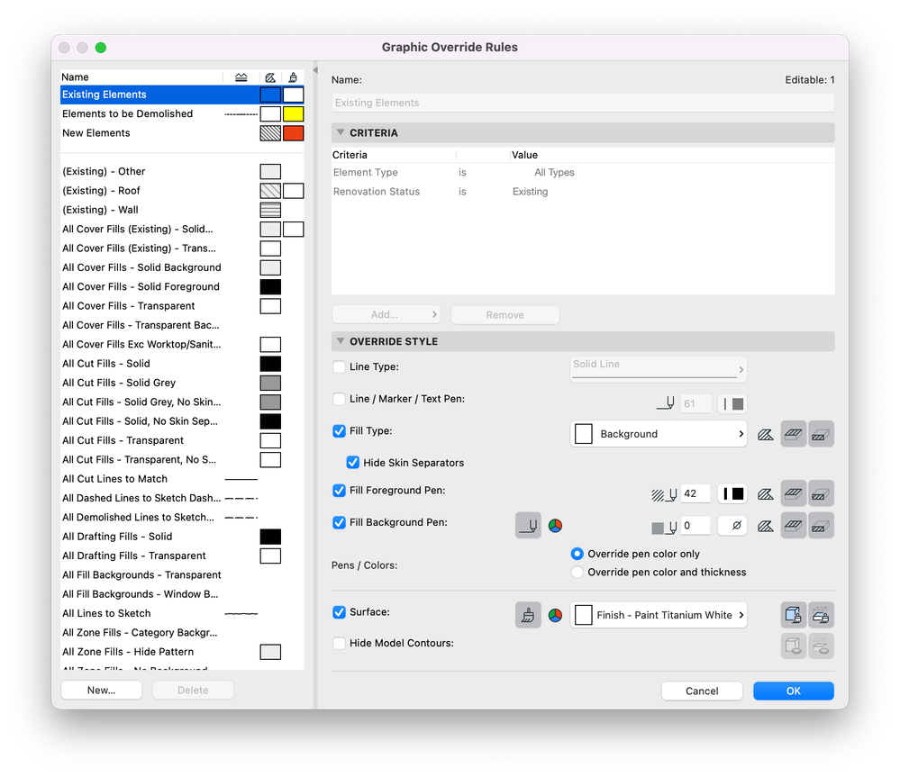

Assuming I have understood what you are trying to do correctly I think the issue is that you need to tell the Renovation Filters for the Existing Graphic Override NOT to override drafting fills. See attached screenshots.

The shadow appears to be overlaid on the elevations as a drafting fill.

THANK YOU LEE.
it was indeed these settings as you pointed out.
Seems somehow these settings I had them off/tweaked/messed with...whatever...and thru my entire shadow fill patts off. this did the trick. thank you.
