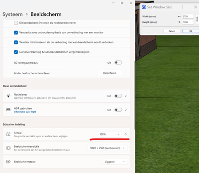

Stefan Videnov
The resolution seems to be bound not only by the resolution of the screen but also by the scaling. By using a screen scaling of 100% (rather than the recommended 150%) I do get higher resolution in the view and also in the layout.
