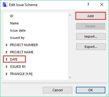

I have a basic procedure question about change orders once the project has started construction. I have been watching some tutorials on this and I seem to be missing a step.
When I issue for construction, i simply put a date and description in the titleblock, print a PDF and send out that package.
From there I start the change orders, but I see that I have to actually issue the set with in Archicad. Does this need to be done so that the revision will show up on the title bloc automatically?

The default date in the Revision History object that is placed on the Master Layouts calls on the automatic Date. This system date just pulls today's date. If you want to use your own date, you need to add a new filed in the Issue Scheme. You can do this in your template and/or when you create a new issue.
Then you edit the Revision History object on your master layout(s) to call this new date field.
Cheers,
Link.

Thanks Link
Ill play around with it and will get the hang of it.
