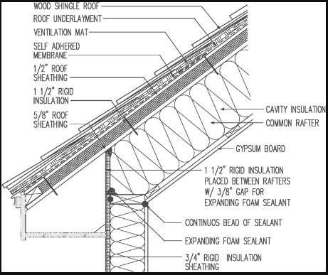

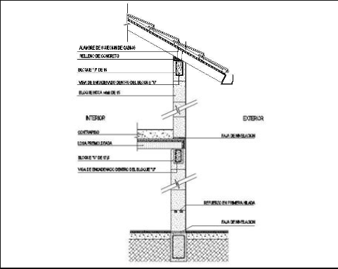

Hello,
I need help with Archicad about the detailed viewing of the walls and roof. I want to do these with my design in detailed view, the ones showed below but i don't know how to do it.
This is in Archicad 25
4 REPLIES 4
Maleng
I want to do these. Above but currently it only makes me do bland walls that doesn't have any features added to it
Create the model as accurately as you can.
There is an old motto - "Model it as it is built".
Generally this will be good for section up to about 1:50 scale.
For larger scales you can use the detail tool (this give you a nice reference marker).
You increase the scale and add 2D annotation (lines, fills, 2D objects) to get the level of detail you need.
Some of the fills (hatch patterns) for thing like insulation and concrete may come directly from the model if you have the correct building materials set up.
Otherwise overlay 2D fills.
The roof shingle or tiles are unlikely to be modelled in Archicad (unless you use an add-on for a roof surface - but try not to do that - too many polygons).
So there you either draw fills and multiply them or look for a 2D object that can take care of them - it just depends on what objects you have available in your (the default) library.
I can't really help with that as I have my own custom library.
