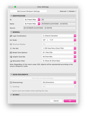

The scheduled items go missing (Sometimes all of them other times only some items ) and/or the row height gets messed up. It doesn't happen always therefore I can’t recreate it every time after it happens to try to figure out what the problem is. One thing I have identified as a common denominator on all the projects where it happens is projects/files where I'm using various renovation filters. The Renovation filter option in the view settings for these schedules is set to "Show All".

In this example, I have a schedule that is scheduling items on different renovation filters. In the video; When I update the drawing/schedule you can see how upon completion some of the items go missing. In this case, all of the Demo items go missing except for item D16 that happens to be on a locked layer. I then Open the source view to go into my schedule, and I find all the items there, but the row size gets messed up, I then proceed to press the "Resize rows to fit content" button to fix the size, go back into the layout, update, and things go missing again. I re-did the previous steps, and it fixed itself on the second try, but sometimes it takes more attempts of poking around each of the schedules in the project to get it to work and it's very frustrating.
I matched the view settings of these schedules to the drawings it's referencing notes on, so all the elements that are going missing are turned on on this layer 0ination. I have also tried setting the layer combination to "Show all and unlocked" and it still happens .I matched the view settings of these schedules to the drawings it's referencing notes on, so all the elements that are going missing are turned on on this layer 0ination. I have also tried setting the layer combination to "Show all and unlocked" and it still happens .

I just discovered your post after our firm had the same issue. We also noticed that the issue was consistent with having a renovation status (in our case the view settings of the schedules was the issue).
Try right clicking on your schedule in the view map, going to view settings, and changing the renovation status to a known setting that includes whichever renovation statuses you want to include. Also make sure to right click and redefine with current view settings after making the change.
