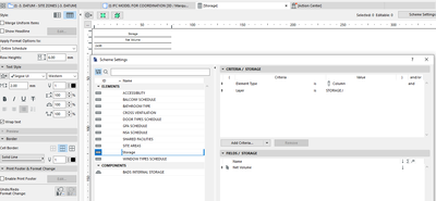

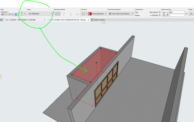

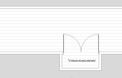

Sure mate, so imagine you got a storage space defined not by a piece of furniture that we could schedule with your expression, but like a tiny room with shelves fixed on the partition for instance, or a cleaner room to store brooms, vacuum and stuff.
The method I was using to schedule storage before you gave me your neat solution was the following:
Placing columns set on a hidden "storage" layer with a specific intersection number to ensure it doesn't mess with anything. Then you create a schedule that will measure the column volume. I usually gave it dedicated material to easily identify them.
You could probably do the same with zones or many other methods, we were using columns back then so we could define specific overrides on a work-view depending on how high they were, their bottom offset, which made it easy to maintain them in the kitchen for instance. If it was a 100mm offset + 800mm high then it was a typical kitchen cabinet, if 1500 offset and 600 high, a top cupboard.
