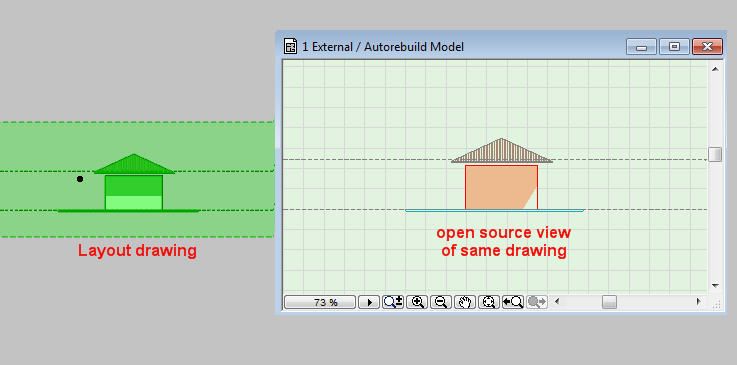

I have just come across the same problem (don't use shadows in elevation very often).
If set to custom angle then they seem to update on layouts fine if that angle is changed.
But if set to "As in 3D window" then they no longer update if the north point is changed.
Open the source view of the elevation and you will see the correct shadows.
But nothing I try will update the layout drawing.
Apart from deleting the view and creating a completely new one and adding that to the layout.
What am I missing here or is this a bug.
I tried with a completely new file and a simple box with roof just as a test in the image attached.
The same problem exists in 15 as well.
Will check back in older versions just out of interest.

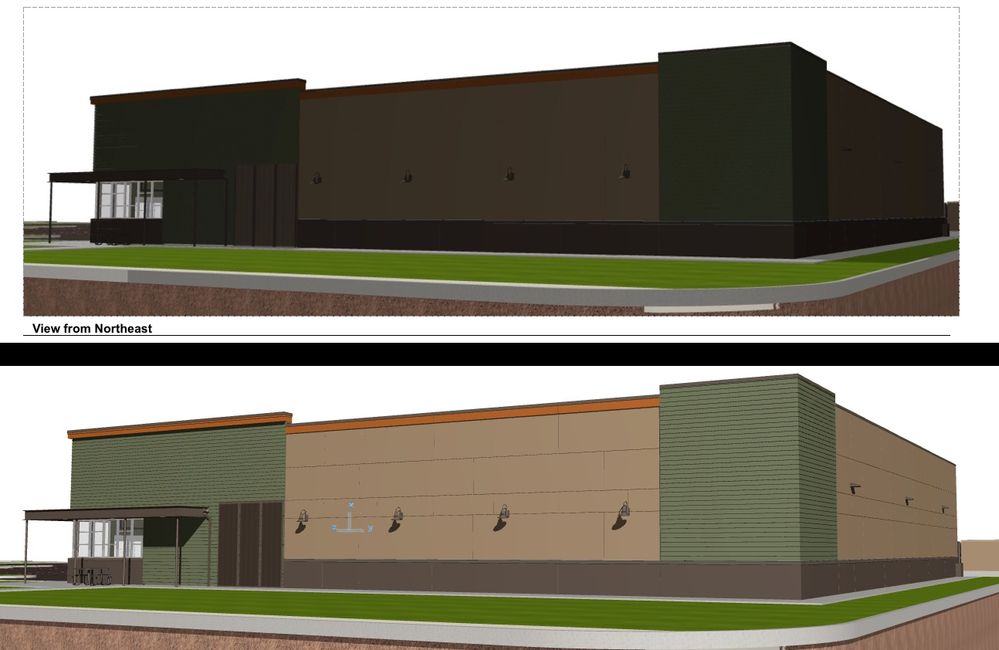

I'm having this problem in AC20 in the 3D window. Sun angle of the View is shown differently in the Drawing placed in the Layout. Open View from the [incorrect] Drawing and it is shown correctly.
MacBook Pro Apple M2 Max, 96 GB of RAM
AC27 US (5003) on Mac OS Ventura 13.6.2
Started on AC4.0 in 91/92/93; full-time user since AC8.1 in 2004
Laura Yanoviak
This is great -- my entire building is in the shade.
Recreating the Views is not a solution in this case -- I cannot fix.
