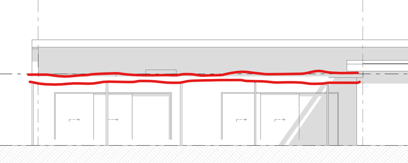

My beams just show as a white fill in elevation view. How would I fix this?

So you can select the beam that is there?
Can you drag a copy to the side and see that beam?
I am wondering if the top and bottom are being hidden or surfaces are merging.
Or maybe the layer is turned off.
Is the outline pen white?
clauds1223
I changed the structure and that fixed it. The pen settings for the previous structure had white uncut lines/ white surfaces.
