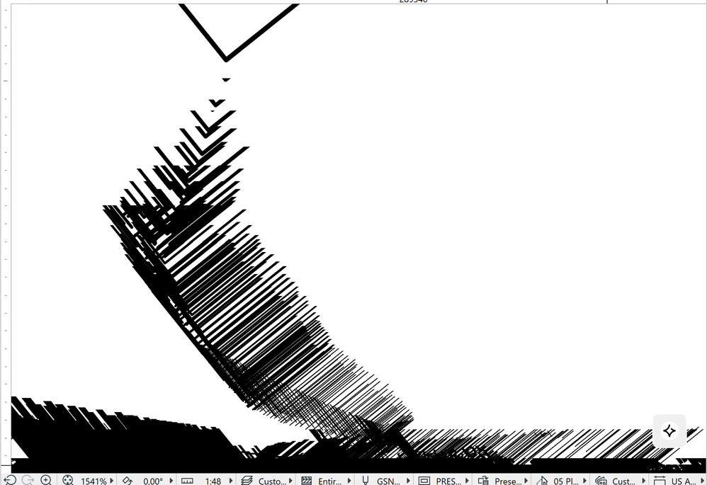

What could be the cause of the following issue in ArchiCAD 29?

It could be a "far from origin" issue.
See here:https://community.graphisoft.com/t5/Project-data-BIM/Far-From-Origin-Troubleshooting-Guide/ta-p/3042...

is this an exploded DWG? my guesses are:
-extents too far from 0,0,0
-excessive content in a single view (have seen similar with 100,000 fills/lines/etc. in a single worksheet)
-scale issue (contents of dwg at large scale, then reduce view's scale after exploding)
more than likely it's a work-environment bug that should sort itself out after restarting.

I am not psychic, so I will guess what that is.
if the problem is when panning, or zooming in and out, the screen gives a lot of cropped versions of itself, like drawing part of the image and not having time to finish the image then drawing the next bit of the image as the screen moves, leaving fragments of the image, making a mess that persists?
when that happens to me, I think it is caused by a screen graphics layer/channel error/issue of the graphics card, so I move the Archicad window to a different screen, then back again, and the problem goes away.(yes on a windows computer)
The reason I'm guessing this is because the zoom is 1541%, the lines vary in width, and seem to be oddly parallel, with neat slices like they are from the screen cropping edge, almost like its a single element being dragged across the screen while zooming in and out.
And because I'm not psychic, I don't even know if that is the question from the image and description.
I'm sorry I can't help.

It's not about an exploded DWG, but local georeferenced data in DWG related to the project site I am working on.
3 weeks ago
This happens when zooming in the drawing into the 2D window. It's about a georeferenced project through which other consultants collaborate using software programs from AutoDesk.
3 weeks ago
A georeferenced drawing worked on by consultants using Autodesk products, would make me guess that you have a reference point a few thousand kilometers from the relevant data in question... Hopefully it is on it's own layer that you can just remove...

When such graphical issues are happening, it is always a good idea to update your graphics card drivers to the latest version as a first step.
3 weeks ago
The graphics card driver as well as the windows software are up-to-date.
