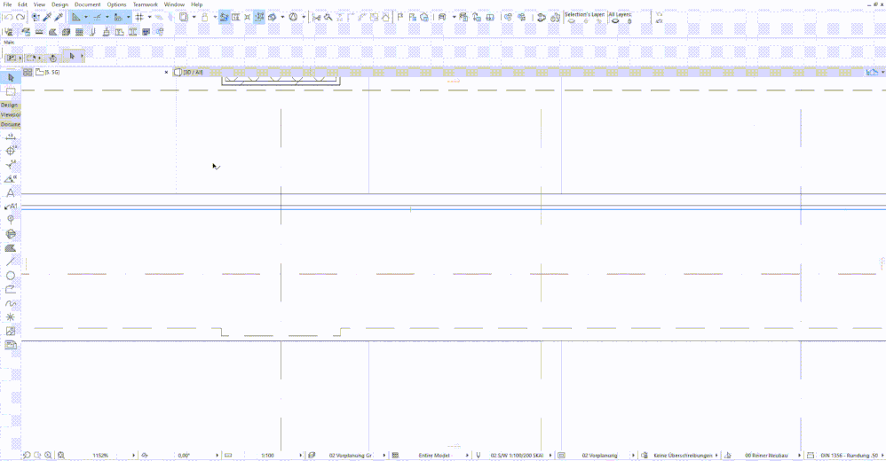

I had exactly the same problem with the dimensioning. Problem was I had very detailed railings on the plan. MVO doesn't helps with this. If I hid the railing layer, the problem disappeared. In my opinion, this is a bug.
Try to hide the railing layer.

Andrii Levko
Just look
It is after hiding layer
Andrii_test - after hiding layer.gifI am wondering what the dependence is.
