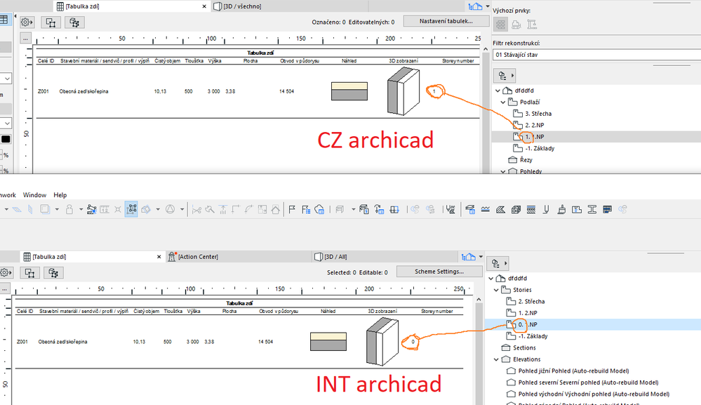

HI, i have run in to a problem with parameter "Home Story Number" in different language versions of Archicad. We wanted to use home story number parameter to describe zone code so zone coud be copied from one story to another and woud change their code automaticly. Problem is that we use International and  Czech version of Archicad in the office at the same time (international team of architects). And these language version dont have same storey number for ground floor nd consequently neither do the others. In INT version it is "0" an in CZ "1".
When we create file in CZ version and open it in INT version it shows different story numbers so all calculations and schedules are wrong.
Whats the reason Graphisoft did this and is there solution which will provide same results in all language mutations?

You actually don't have a "0" story number in the CZ localisation of Archicad?!! That is strange.
I think this question should be addressed to your local GS representative as they are responsible for any region specific trims.

The USA version does not have a '0' storey either.
As you have discovered, there is not problem sharing the model between different language versions - the model will remain exactly the same and storey number convert to suit.
The problem is because you are listing or labelling the actual storey number.
It is still correct for each version - it just may not be what you want to see when you compare the two side by side.
Why there is this difference I am not sure anyone actually knows.
