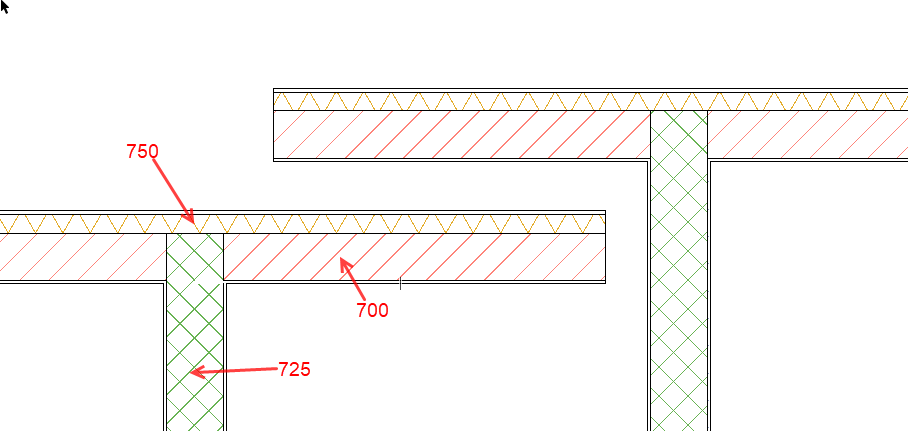

Hi, I know it's a typical topic but I really need to work this out. I'm trying to solve these junctions. Top left and right corner: i can solve it by increasing the material priority of insulation ok but it will mess up the bottom left T junction. I don't want to create and insulation with a stronger material priority of the concrete, it seems stupid. And I don't wanna create two different insulation material with different material priorities as too because it will create unnecessary lines. Why does archicad not use core and finishes priority as well? it would make these kind of connection so much easier.

OK, I had a look at the file - thanks for sending.

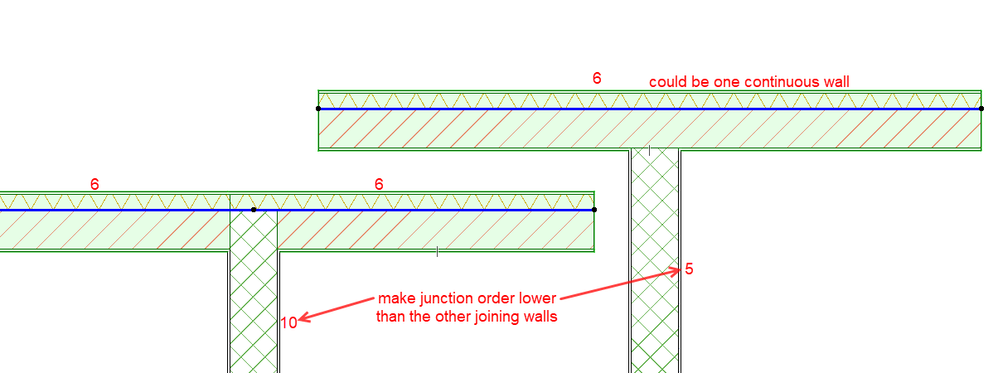

The junction order helps a bit - the higher junction order will dominate the lower ones.
So just changing that you will get this.
Whether you have two wall or one continuous wall along the top will not matter.
The horizontal brick walls just need a higher junction order than the vertical wall.
However, if you want the concrete (vertical wall) to cut the brick (horizontal) wall, then you need to play with the strengths of the building materials.
Concrete needs to be stronger than the brick and the insulation needs to be stronger than the concrete so the insulation does not get cut.
But then this create a problem when you have 3 walls all with insulation - the insulation is strong and will cut other skins.
So you have to create a new insulation material that is weaker and also create new composite wall that uses that weaker insulation (i.e 'brick wall - strong insulation'  and another composite 'brick wall - weak insulation').
Now use the weak wall when you want it to be cut.

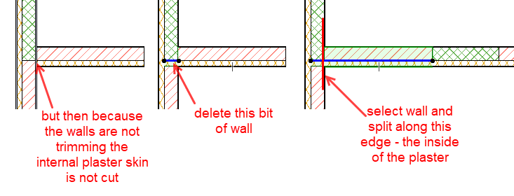

Or to save doing that, just control how the walls are cut - overriding the automatic trimming.
You may have to re-trim every time you move or edit a wall as it will automatically trim to the reference line of the other walls when you edit it.
You can also place them in different layers with different intersection group numbers and they will not trim with each other.
But then another problem you will have is the plaster skin will not be cut as the walls are not trimming to each other any more.

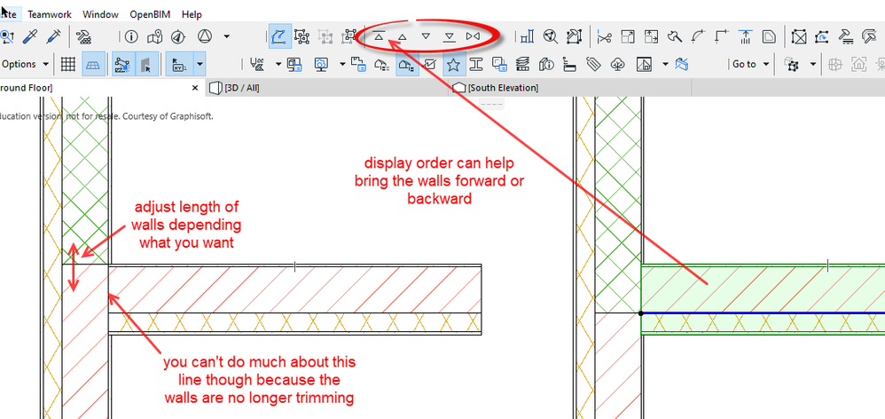

Display order can help with that.
Although now the walls are not trimming, even the same building materials will not join.
It really does get quite complicated depending on the walls you want to trim.
