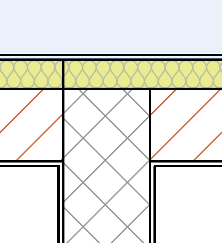

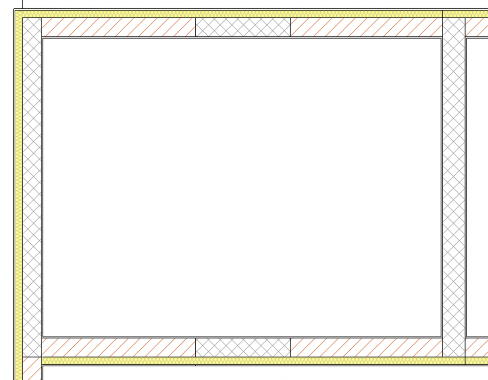

Hi, I know it's a typical topic but I really need to work this out. I'm trying to solve these junctions. Top left and right corner: i can solve it by increasing the material priority of insulation ok but it will mess up the bottom left T junction. I don't want to create and insulation with a stronger material priority of the concrete, it seems stupid. And I don't wanna create two different insulation material with different material priorities as too because it will create unnecessary lines. Why does archicad not use core and finishes priority as well? it would make these kind of connection so much easier.

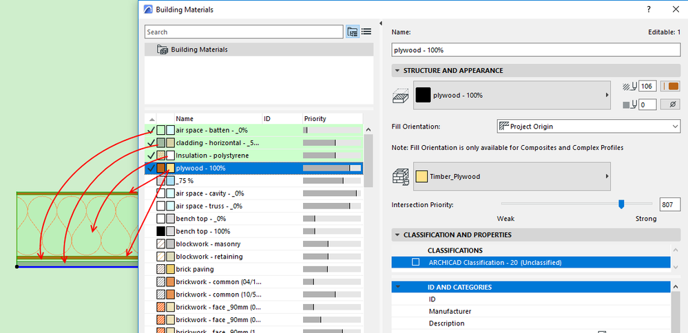

The outer skin needs to be the strongest material.
The insulation slightly weaker but it must be stronger than your concrete (diamond hatch) and brick (diagonal hatch).
The concrete and the brick you can decide which is stronger than the other, but both must be weaker than the insulation.
The inner plaster skin must be weaker than all of them.

thanks Barry! i appreciate your help. i’ve already tried it but if i do so, i’m the bottom left corner i’ll end up with the insulation interrupting the brick layer, i don’t want that. so i tried creating a new insulation material with a different priority but it will create new unwanted lines were the two different insulations get in in touch, in particular on the mid-bottom conjunction wall.

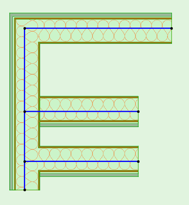

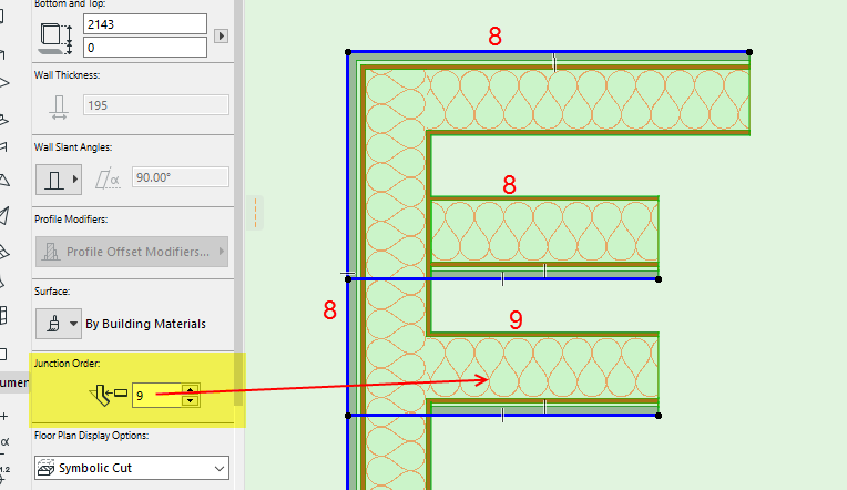

I don't have your exact walls setup, but try playing around with the junction order to see if that will help.
See here, same wall, different junction orders.

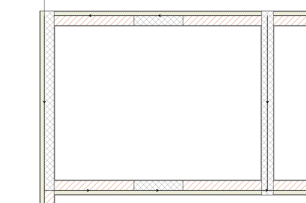

Hi Barry! thanks for the help. I've tried as you sad, I've set every building material priority to the same value and work with the priority junction. I've managed some how but the plaster keeps causing trouble with different composite walls. any idea how can I fix this?
ps: it's a little work around for the plan but if I switch to an elevation, setting every material priority to the same is gonna cause trouble

I am not sure what you mean by "I've set every building material priority to the same value".
You still need stronger/weaker building materials.
That should work in most cases.
Then in those that don't, try adjusting the junction order.
I am not sure why that one line is extending through your insulation skin.
Sometimes it is just not possible for every junction to trim as you want it.
Then you can 'cheat' and add a complex profile column (with the fills arranged as you want them to be) to the junction.
