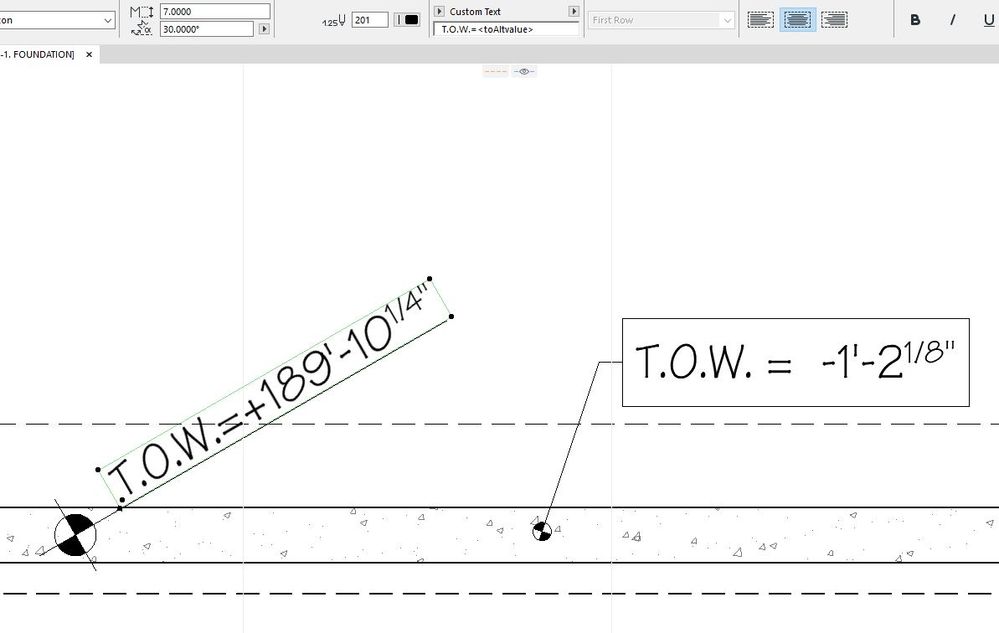

I'm looking to speed up labeling top of wall to sea level. We currently do this manually with the Level Dimension Tool, but frequently this takes up a lot of space in the wrong place.
I'd like to grab all my foundation walls and go to Document | Label Selected Elements instead using the label in the attached pic (on the right side). The Elevation Label 21 gets close, but only options are Project Origin and Current Story - no Sea Level option. Is there another way, or a 3rd party label anyone knows of?

However we had an internal discussion about this last Friday and decided to use the following:
1. Crawlspace: Elevation Label 21, Custom Settings | Label Content | Reference Story > Project Origin
2. Basement: Elevation Label 21, Custom Settings | Label Content | Reference Story > Current Story
We're not fighting the program then. Crawlspace labels will have a negative value dimension from main floor/project origin and basements will be positive from top of basement slab.
