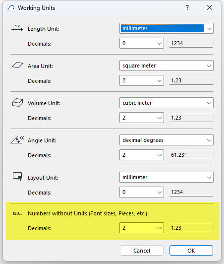

My text box is refusing to allow for a non whole number text size i.e. 2.5mm, 1.8mm ect. it rounds up to 3mm or 2mm respectively. All my line weights and line types are messed up as a result. Please help. Thank you.  
Please see attached below:

Go to Project Prefereneces > Working Units, then up the numbers! 🙂
I use the maxium (4). Now you should be able to set the font size accordingly.
Solution
The settings dialogue in English ...
Solution
