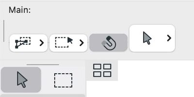

I just tried it and it works... I think what may be happening is that you have your magnet/quick selection button turned off in your Info Bar. When "off" you can NOT double click on text to edit. When turned "on" then you can. I just tested it and it works.

I have tried highlighting the magnet as suggested and that doesn't seem to do it. I hve tried the idea Lee mentioned. But he can only use one hand. I am now sure it is in the accessibility option in the computer. preferences. Thanks for the suggestions.

Hello, you suggesting about the magnet/quick selection does work. My earlier response about this was incorrect. With the magnet on it is working.  Thank you so much
