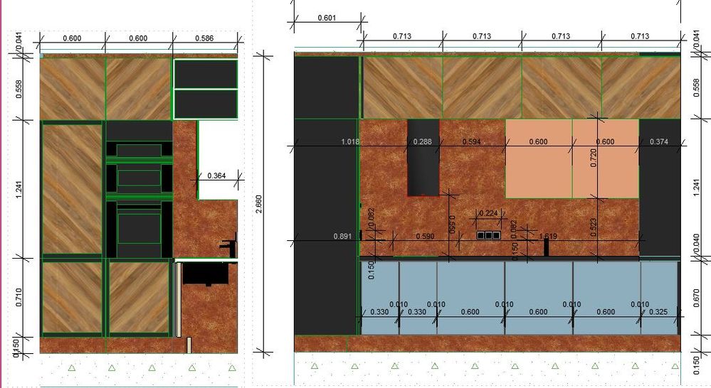

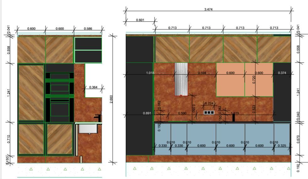

Please advise on resolving following issue: I have created kitchen sections and placed it on layout of document to save in PDF with additional project details. Somehow textures of roundish objects do not show correctly in PDF, such as sink and hood. Screenshot 1 shows how objects look on the layout, while screenshot 2 shows how it looks in saved pdf. Object turn white/grey. How to force those objects to look the same as on the layout without turning off textures completely.

I checked the screenshot, but due to its resolution, I couldn't figure out the texture being used in the screenshot from PDF output. My first guess would be there might be a problem with the used surface. I would try using another surface with a different texture, or even removing the texture from the affected surface and try again.
If only this surface is behaving badly, then I would separate the object and the surface into a new file and try to export the PDF there. If it still happens, then I suggest forwarding the smaller file to the local support team for further investigation.
