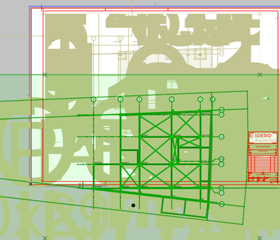

Trace-reference layout on layout, text size issue
This is what I am getting on AC25 4013 on MacOS Monterey, when I trace-reference some other layout: the texts in the traced master, and traced drawing including labels, appear huge (most likely in a paper size-model size tracing screwup, but I haven't checked).
I think I have seen this recently on AC24 too but I am not positive.
text size issues on trace-referenced layouttext size issues on trace-referenced layout

@Ignacio Azpiazu Is the trace reference possibly (a DWG) imported at the wrong scale e.g. you imported at 1:1 but the trace view is displaying at 1:100?
The trace view should ideally be linked from the View Map rather than Project Map, that way you can check what will be displayed including text sizes.
It is a layout traced from a layout.

@Ignacio Azpiazu I'm still on Big Sur but I have AC25 5005 running and I'm not seeing Layout on Layout scaling problems. It may be Monterey related (or 4013). There seems to be a lot of bugs blamed on the macOS version just now. Have you reported it to your local support?
Man, if you knew my local Support. Trust me that I know what I am doing.
